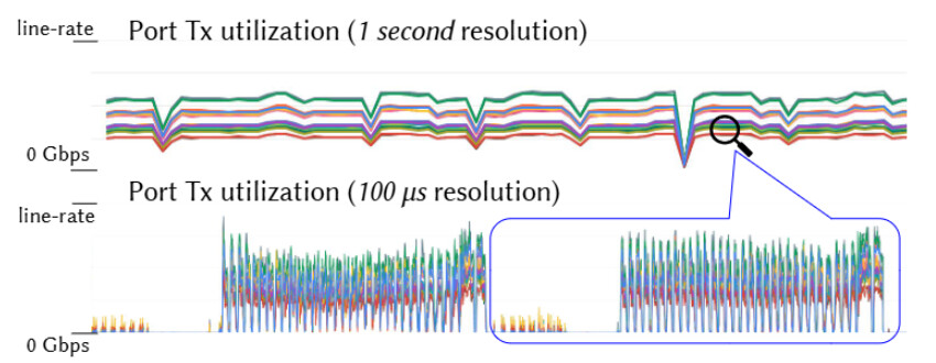

Modern datacenter workloads, especially distributed AI/ML services, generate synchronized microbursts and rapidly alternate between congestion and idle capacity. End-host transports need timely and precise network feedback to respond to these changes, but the signals available in deployed networks are limited. ECN provides only a binary indication and must be averaged over many packets, while RTT and end-to-end delay combine congestion from multiple hops and cannot identify the true bottleneck. More expressive in-band telemetry systems such as P4-INT, IFA, and iOAM can report per-hop state, but their variable-length headers complicate line-rate parsing, consume bandwidth, interact poorly with MTUs and NIC offloads, and become entangled with tunneling and encryption. The paper asks whether a datacenter network can expose fine-grained congestion information on every packet while remaining simple enough to deploy across existing switches, NICs, and transport stacks.

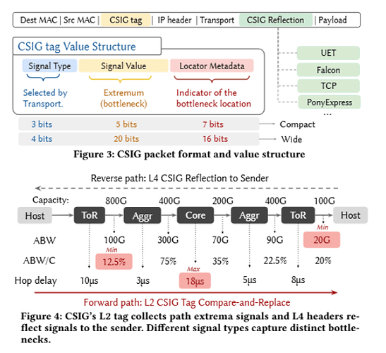

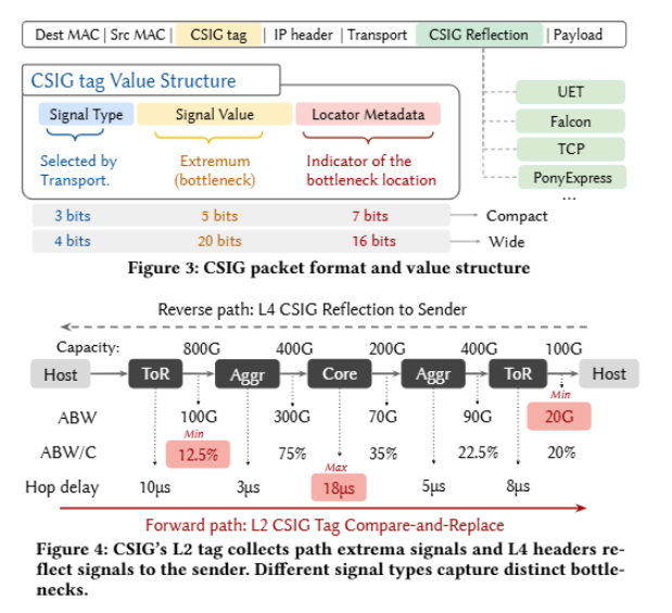

CSIG’s central insight is that transport control loops usually do not need a complete trace of every hop. They mainly need the value and location of the single bottleneck that limits the flow. CSIG therefore carries a fixed-size summary of a path extremum rather than appending telemetry at each hop. A sender places a CSIG tag at the end of the Layer 2 header and selects a signal type. As the packet traverses the network, each switch compares its local measurement with the value already in the tag and replaces the value and locator only when its condition is more severe. For example, switches compute the minimum relative available bandwidth, min(ABW/C), or the maximum per-hop delay, max(Delay). The receiver extracts the resulting bottleneck signal and reflects it to the sender in a transport-specific Layer 4 header.
The Layer 2 placement is a deliberate deployability choice. The tag remains at a predictable offset, is visible to switches without parsing inner transport headers, and is compatible with common Layer 3 and higher-layer tunnels as well as end-to-end encryption. CSIG defines a 4-byte Compact format and an 8-byte Wide format. The Compact tag contains a 3-bit signal type, a 5-bit signal value, and a 7-bit locator; the Wide tag provides a 20-bit value and a 16-bit locator. A packet carries one signal type, but a transport can alternate signal requests across packets when it needs several metrics. Since the header size does not grow with path length, the Compact format adds less than 0.2% bandwidth overhead for 4 KB or 9 KB MTUs and can be enabled on every data packet.

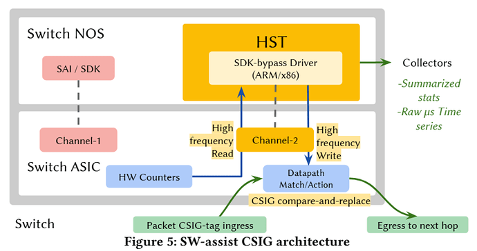

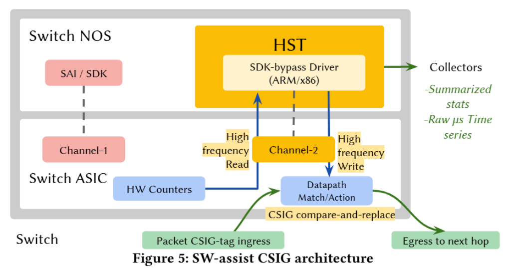

The paper presents both hardware-native and software-assisted switch implementations. New ASICs can compute per-packet signals such as available bandwidth, normalized queue depth, and per-hop delay directly in the data plane, with measurement intervals as short as approximately 1 microsecond. For brownfield deployment, the authors build a user-space High-precision Switch Telemetry (HST) agent. It bypasses slow vendor SDK paths, reads hardware counters through a dedicated CPU-to-ASIC channel, computes a bucketized signal, and writes the current value into switch tables. The ASIC then performs compare-and-replace operations at line rate. This software-assisted design works on commodity ASICs dating back to 2010, although its updates are coarser, typically around 100 microseconds, and it usually supports only the Compact tag. The authors validate CSIG across five switch-silicon generations, four NIC generations, and five transport stacks, including Linux TCP, PonyExpress, Falcon, RoCE, and a virtualization stack.

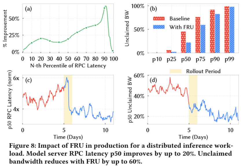

The evaluation combines a deployment across hundreds of production clusters in Google’s Jupiter network, controlled testbeds, and simulations. In production, adding FRU to Swift reduces median RPC latency for distributed LLM serving by approximately 20% and reduces median unclaimed bandwidth by 60%. It also reduces median KV-cache transfer time by 5.8%, or 9.3% under peak query load. The improvement is concentrated in clusters with substantial unused bandwidth and is negligible when little spare capacity exists, which is consistent with FRU’s purpose. The 99th-percentile RPC latency does not improve noticeably because the deepest tail occurs when available bandwidth is already zero. FRU increases p99.9 RTT by less than 10%, reflecting a tradeoff between faster capacity use and slightly more queueing.

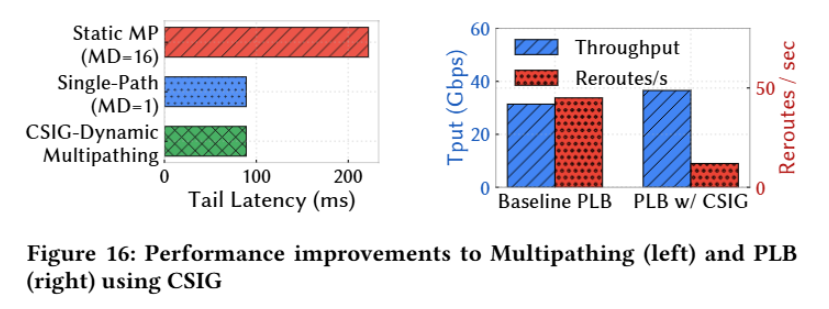

In a controlled incast experiment, CSIG-guided dynamic multipathing reduces p99 latency from 222 ms to 89 ms, a 2.5x improvement, by recognizing a last-hop bottleneck and draining unnecessary subflows. CSIG-informed PLB lowers rerouting from 45 to 12 times per second and increases throughput from 31.4 to 36.5 Gbps under heavy background load. Simulations show that replacing NSCC’s cumulative path-delay signal with bottleneck-only max(Delay) improves the victim-to-non-victim throughput ratio from 4.5:1 to 1.4:1; for collective-like traffic, it improves victim throughput by about 65% and reduces flow completion time by about 39%. Across the tested NICs and switches, the 4-byte and 8-byte tags impose less than 0.1% goodput overhead and less than 0.01% impact on packet rate or latency.
