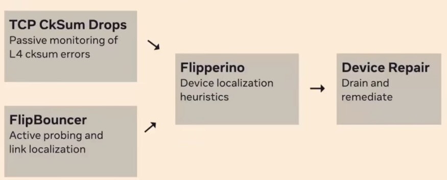

TCPCkSumDrops for fleet-wide passive detection. TCPCkSumDrops is an eBPF program running on receiving hosts. It records every TCP checksum error dropped by the kernel and attaches source and destination context, including host, NIC, rack, datacenter, region, and service metadata. Because the program runs only when a checksum error occurs, its overhead is low. The resulting data identifies heavy-hitter source hosts, destination hosts, and rack links, but it cannot see intermediate fabric or spine switches.
FlipBouncer for active link localization. FlipBouncer extends path-monitoring ideas from NetBouncer. It pins probe packets to selected paths with IP-in-IP, checks whether returned payloads match what was sent, and aggregates path observations to infer faulty links. Randomized source IPs increase entropy in switch-ASIC memory accesses, while randomized payloads expose more corruption patterns. Because bitflips are sparse, the system also adapts the fault-inference procedure to avoid incorrect localization from only a few detected packets.
Flipperino for device-level attribution. Passive and active signals identify bad links or candidate endpoints, while operators ultimately need a device that can be drained and remediated. Flipperino applies two heuristics. The dominant-rack heuristic filters intra-datacenter checksum drops and selects a rack explaining more than half of the drops; a single explanatory host is blamed directly, otherwise the rack switch is selected. The voting heuristic assigns votes to both endpoints of links reported by FlipBouncer and selects the highest-voted device, again refining to a host when one host explains the observations.
Flippy for port-level reproduction. After a switch or link is localized, Flippy runs a loopback test on an isolated switch port to reproduce packet corruption and confirm the specific port. The three components are complementary: passive monitoring covers production traffic and host/rack outliers, active probing reaches fabric and spine paths, and loopback reproduction provides final device evidence.
A staged production workflow. The workflow is detection, candidate localization, active probing, device attribution, and reproduction. Once a device is confirmed, operators can drain it from production. The system is designed for in-datacenter operation and does not require recabling or special tester hardware; tests are scoped to selected hosts and links to limit interference with normal traffic.

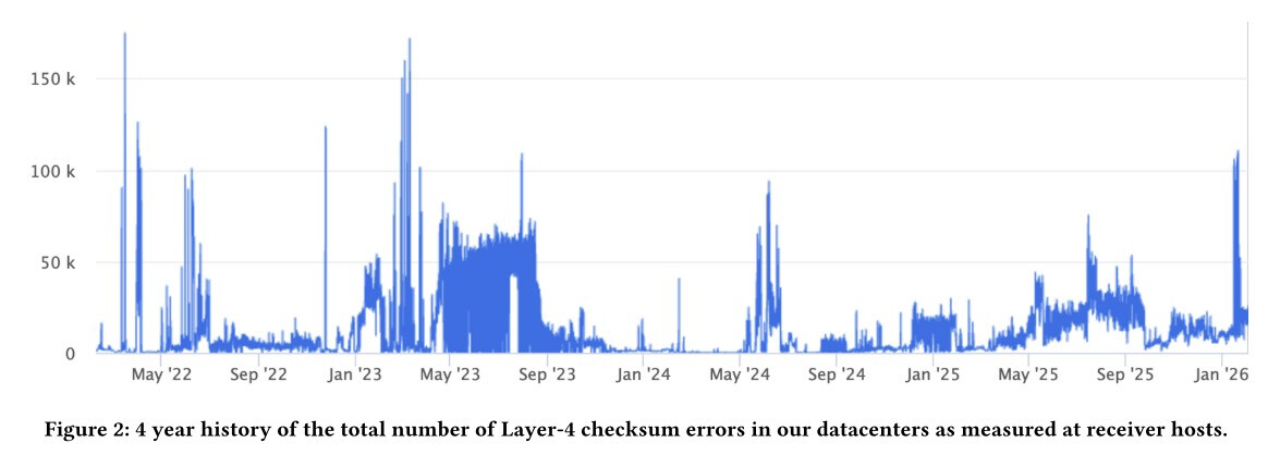

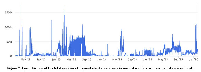

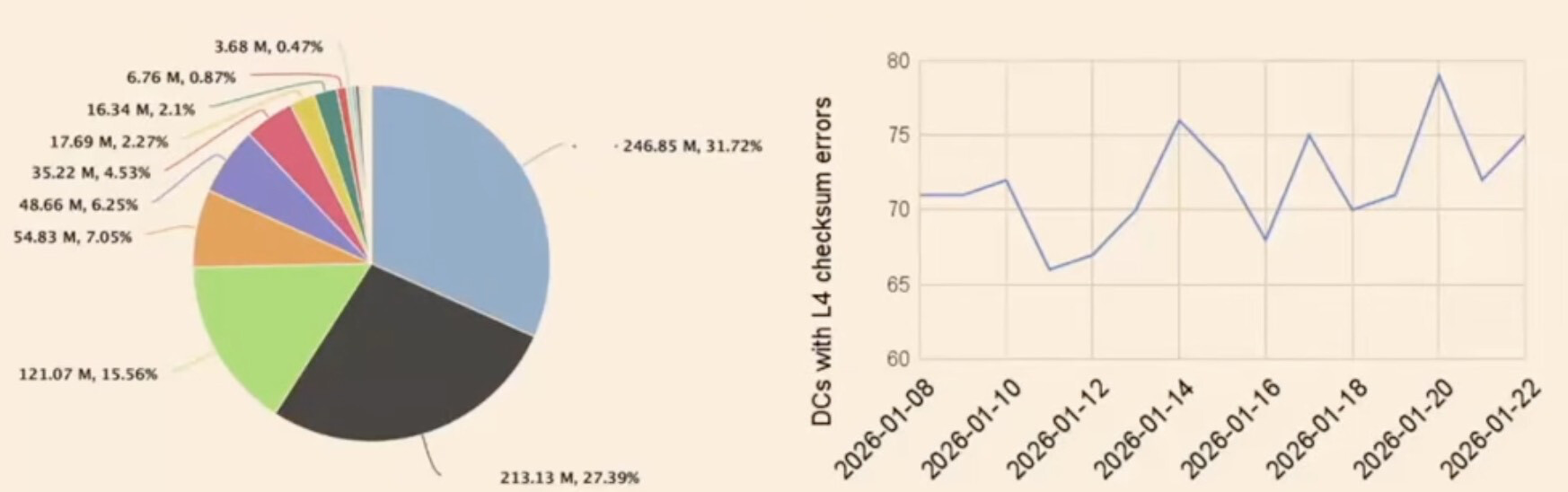

Fleet-scale error distribution. The presentation reports that a small number of datacenters account for most checksum errors, while a long tail of more than 70 datacenters still contains errors. This motivates a continuously running fleet-wide system that can find both heavy hitters and sparse tail devices. The paper reports up to four years of operation for Flipperino’s components.

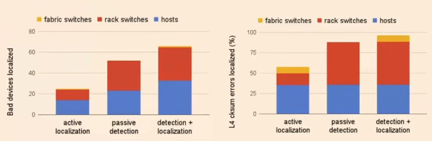

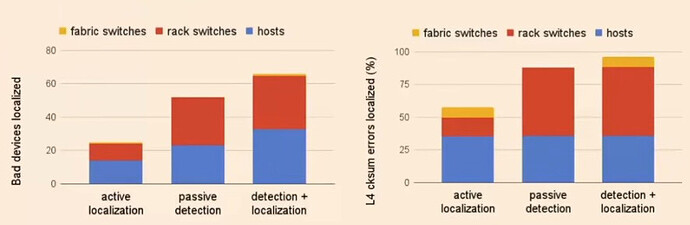

Complementary localization signals. TCPCkSumDrops alone identifies devices responsible for 87% of Layer-4 checksum errors. FlipBouncer finds almost 30% more bad devices that passive source and destination context cannot localize, and the combined system attributes about 97% of errors to localized devices. The result demonstrates why neither passive nor active monitoring alone covers all topology layers.

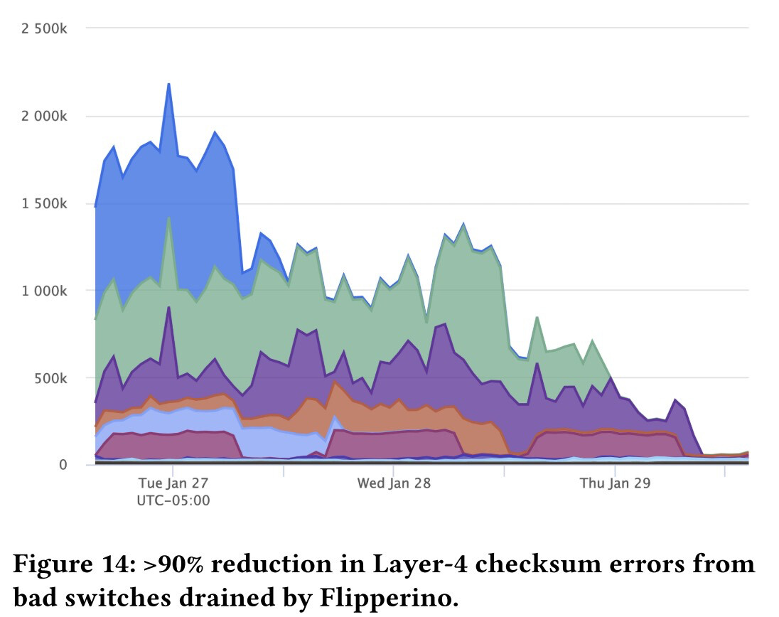

Remediation and reproduction. Enabling Flipperino in seven datacenters reduced Layer-4 checksum errors by 90% within three days. Some devices had been corrupting packets for weeks before identification. Flippy reproduced and localized corruption on eight switches in the last three months, including seven rack switches and one fabric switch. These measurements provide evidence that the localized devices were genuine operational faults rather than statistical outliers.
