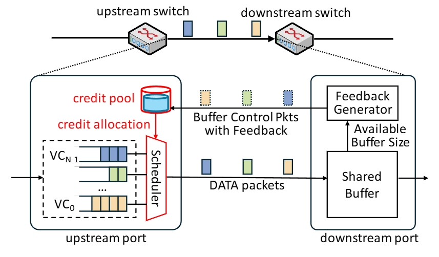

(2) Upstream-driven buffer allocation with UABD
InfiniFlow introduces Upstream Allocates Buffer for Downstream (UABD). For each link, the upstream port maintains a shared credit pool representing the available buffer space at the downstream port. The upstream scheduler allocates credits to VCs when packets are transmitted, enabling immediate buffer allocation without waiting for a separate downstream allocation procedure.

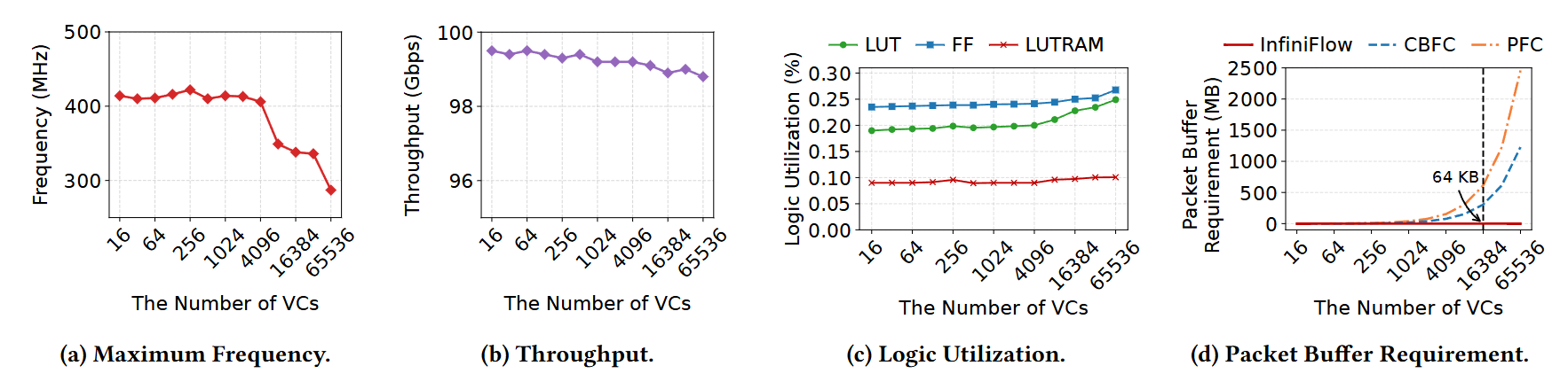

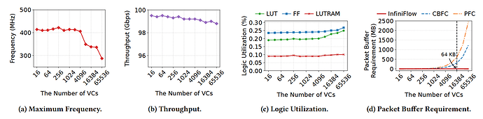

The authors implement InfiniFlow on a Xilinx Alveo U280 FPGA and use NS-3 simulations for larger-scale evaluation.
(1) VC Scalability
For a 64-port switch with 100 Gbps links and 40 MB of on-chip memory, InfiniFlow supports 16,384 VCs using 401 KB of on-chip memory per port. Under the same setting, CBFC and PFC support only 32 and 16 VCs, respectively, giving InfiniFlow 512× and 1024× higher VC scalability. The FPGA prototype also sustains throughput close to the 100 Gbps line rate.
In a 1024-host simulation, approximately 3× per-hop BDP of buffering per port is sufficient for InfiniFlow to approach ideal performance even at 80% load intensity.

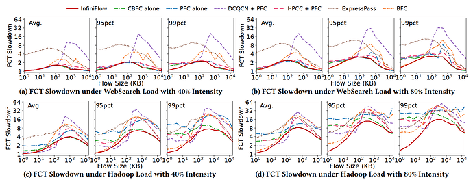

(2) Large-Scale Network Performance

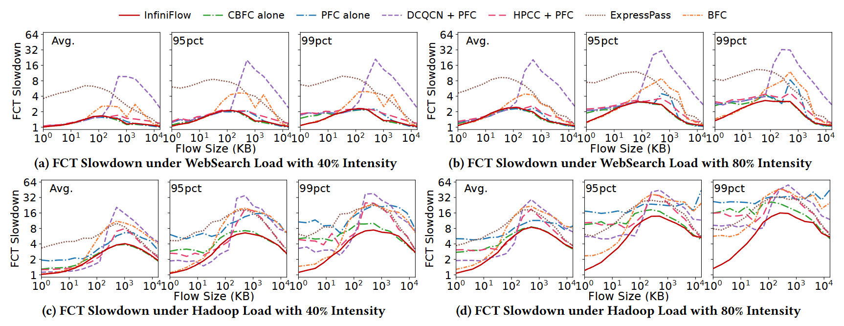

The paper evaluates InfiniFlow on a 1024-host leaf-spine topology using realistic WebSearch and Hadoop workloads and compares it with PFC, CBFC, BFC, DCQCN, HPCC, and ExpressPass. Across most scenarios, InfiniFlow achieves low tail FCT for short flows, with its advantage becoming more pronounced under heavy load and the Hadoop workload. It also maintains low average FCT for long flows across most settings.
Q1: Does your scheduler assume a fixed packet size, or can it handle variable packet sizes?
A1: It does not require a fixed packet size. Before sending a packet, the scheduler deducts credits from the credit pool according to the actual packet length, so packets of different sizes can be handled. The credit pool is maintained in bytes rather than packets. The presentation used packets only for clarity. The scheduling condition in the paper also checks whether the available credit pool can cover the actual size of the head packet.
Q2: If there are multiple upstream ports, do they have separate schedulers, and how do they share the buffer?
A2: In the current design, different ports of the same switch do not share the buffer. Buffer sharing in InfiniFlow is limited to each individual port, so buffer usage is separated across ports. Sharing buffers across multiple ports is considered future work.
