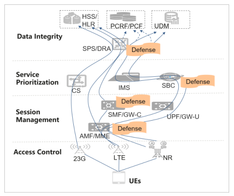

Spillway categorizes the resource consumption process of signaling transactions into four layers. The first layer is AMF access control, which limits traffic as soon as registration or Service Request messages enter the network; this serves as the most critical traffic gate, as rejection at this stage incurs the lowest cost. The second layer resides at the SMF, limiting PDU Session establishment and modification to prevent a single external request from triggering a cascade of internal state operations. The third layer is located at the IMS/SBC, prioritizing voice services—such as VoNR/VoLTE and emergency calls—during periods of congestion. The fourth layer is at the UDM/UDR, protecting user database data integrity through strict backpressure; if the preceding two layers function correctly, this final line of defense should rarely be trigg ered.
The key here is not for each node to maximize its own throughput, but rather to align the ingress rate with the capacity of the weakest downstream node. Even if the AMF has spare capacity, it will proactively drop requests based on the safe handling limits of the SMF or UDM, thereby avoiding failures that would otherwise occur after requests have already entered the system. The paper terms this behavior “altruistic shedding”: local nodes “altruistically” lower their access rates to secure better global goodput and recove ry stability.
This coordination is achieved entirely through parameters already supported by network equipment—such as token buckets, queue depths, query rates, connection pools, and backoff timers—making it applicable to equipment from vendors including Huawei, Ericsson, Nokia, and ZTE. Parameters are deployed via standard O&M interfaces like Netconf/YANG, requiring no firmware modifications. Spillway operates outside the active service path; even if the management system fails, the network retains the last known safe configuration, ensuring no new single point of failure is introduced. (2) Constructing Digital Twins for Tens of Millions of Use rs with CN-DES

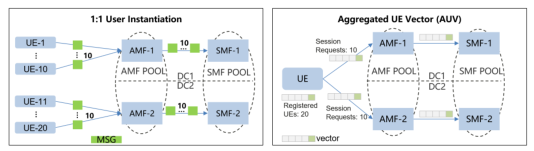

Traditional discrete-event simulation (DES) creates independent objects for each User Equipment (UE)—maintaining state machines, timers, and event queues—resulting in memory usage that grows linearly with the number of users. The paper’s fine-grained baseline crashed after exceeding 128 GB of memory when simulating 17.3 million users, making it incapable of supporting parameter searches that require running a full simulation for e very iteration.
The core abstraction of CN-DES is the Aggregated UE Vector (AUV). Instead of tracking individual users, it aggregates users who share the same protocol state, retry phase, serving AMF, and next-timer bucket into a triplet: protocol state, user count, and next trigger time. Consequently, a single event in the event queue can represent the simultaneous state transition of tens of tho usands of users.
When a user group passes through an AMF token bucket, CN-DES deterministically splits the AUV into “accepted” and “rejected” sub-vectors based on the acceptance probability; before entering the queue, the newly generated vectors are merged with existing ones based on state and time buckets. With populations in the millions, the Law of Large Numbers ensures the stability of this aggregation approximation, while the split-merge mechanism shifts complexity from the number of users to the finite number of protocol states. The system preserves retry and backoff behaviors at a 1-second granularity, aiming to accurately reproduce macroscopic storm dynamics—such as queue backlogs, retry amplification, and user fallback—rather than reconstructing the complete trajectory of ever y indi vidual user.
CN-DES employs a three-stage pipeline: initialization, a vectorized event loop, and telemetry export. It reads topology and traffic snapshots from production logs to generate initial AUVs; the core loop advances state transitions for the entire user population; finally, it outputs CPU usage, queue depth, and rejection counts in the same format as production Prometheus exporters, allowing existing monitoring systems to directly consume the simulation results. Since provincial core networks in China Mobile typically serve between 8 million and 42 million users, and the impact of signaling storms is generally confined to provincial partitions, there is no need to simulate the entire national base of 622 million users in a single run. (3) Using HEBO to Search for Safe Parameters Near t he “Stability Cliff”

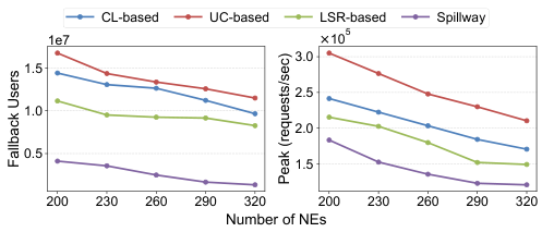

Across network scales ranging from 200 to 320 units, HEBO identified a robust configuration in approximately 100 iterations, whereas TuRBO required about 140 iterations—a 28% reduction in the number of samples. Compared to TuRBO, the parameters identified by HEBO resulted in a more than fourfold reduction in user fallbacks and a 10%–15% decrease in recovery time. Ablation studies further demonstrated that removing safety constraints increased the number of convergence rounds from 103 to 147, while failing to model heteroscedasticity led the optimizer to select unstable configurations, causing us er fal lbacks to surge to 319,160.

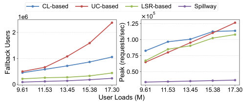

In a scenario where 17.3 million users attempted simultaneous re-registration, Spillway was compared against three industry-standard mechanisms: CPU Load-based, User Capacity-based, and Lookahead Success Rate-based approaches. As the user count increased, Spillway reduced user fallbacks by 80% compared to the best baseline; even as the scale of network units grew, it maintained a reduction of approximately 60%. It capped signaling peaks at around 35,000 requests per second, whereas the CPU load-based mechanism allowed peaks to escalate beyond 120,000 requests per second. While the latter only triggers after the node is already overloaded, Spillway proactively shapes traffi c befo re des tructive peaks can form.
Parameter sensitivity analysis further illustrates the risks associated with critical thresholds: the optimal AMF registration threshold was identified as 12,400 requests per second. Tightening this limit by 9% increased recovery time only marginally—from 314 to 318 seconds—whereas relaxing it by 9% triggered a metastable collapse, pushing recovery time to 340 seconds and resulting in 194,000 user fallbacks. The value of the offline digital twin lies precisely in identifying a stable operating region that is slightly conservative yet safely distanced f rom the “cliff edge” of system failure .
