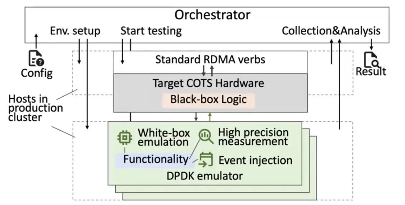

Surround the device under test with white-box DPDK endpoints. Anytest places a small number of hosts in the affected production cluster and keeps the target COTS NIC or switch in its real environment. DPDK emulators replace the missing communication peers with protocol-correct software endpoints. They inject controlled transport events, record packet-level responses, and expose transient behavior that coarse counters erase. An orchestrator configures the experiment, deploys binaries, coordinates execution, collects traces, and produces a human-readable report.
Isolate one RoCEv2 transport role at a time. Anytest uses three explicit roles: the Reaction Point (RP) for sender-side congestion reaction, the Notification Point (NP) for receiver-side notification generation, and the Congestion Point (CP) for switch-side congestion signaling. In an RP test, a target sender NIC runs real RDMA traffic while DPDK emulates NP and CP and injects controlled CNP patterns. In an NP test, DPDK sends packets with controlled ECN marks to a target receiver NIC and records ACK/NACK/CNP outputs. In a CP test, DPDK RP endpoints send traffic through a target switch, while a DPDK NP records packet delay and ECN-marking ratio. This decomposition attributes a deviation to one role rather than to an inseparable sender-switch-receiver interaction.
Inject precise events and measure at microsecond resolution. Anytest controls packet sequences, congestion feedback, ECN marks, loss, reordering, and arbitrary inter-packet gaps. Its measurement pipeline records throughput, packet delay, ECN marking, and control-packet sequences with microsecond-level timing. Hardware timestamps and lock-free SPSC rings keep logging and aggregation away from the critical datapath. Tests suspend service traffic only on selected hosts involved in the experiment; they do not require stopping all cluster traffic, packet taps, special testers, or recabling.

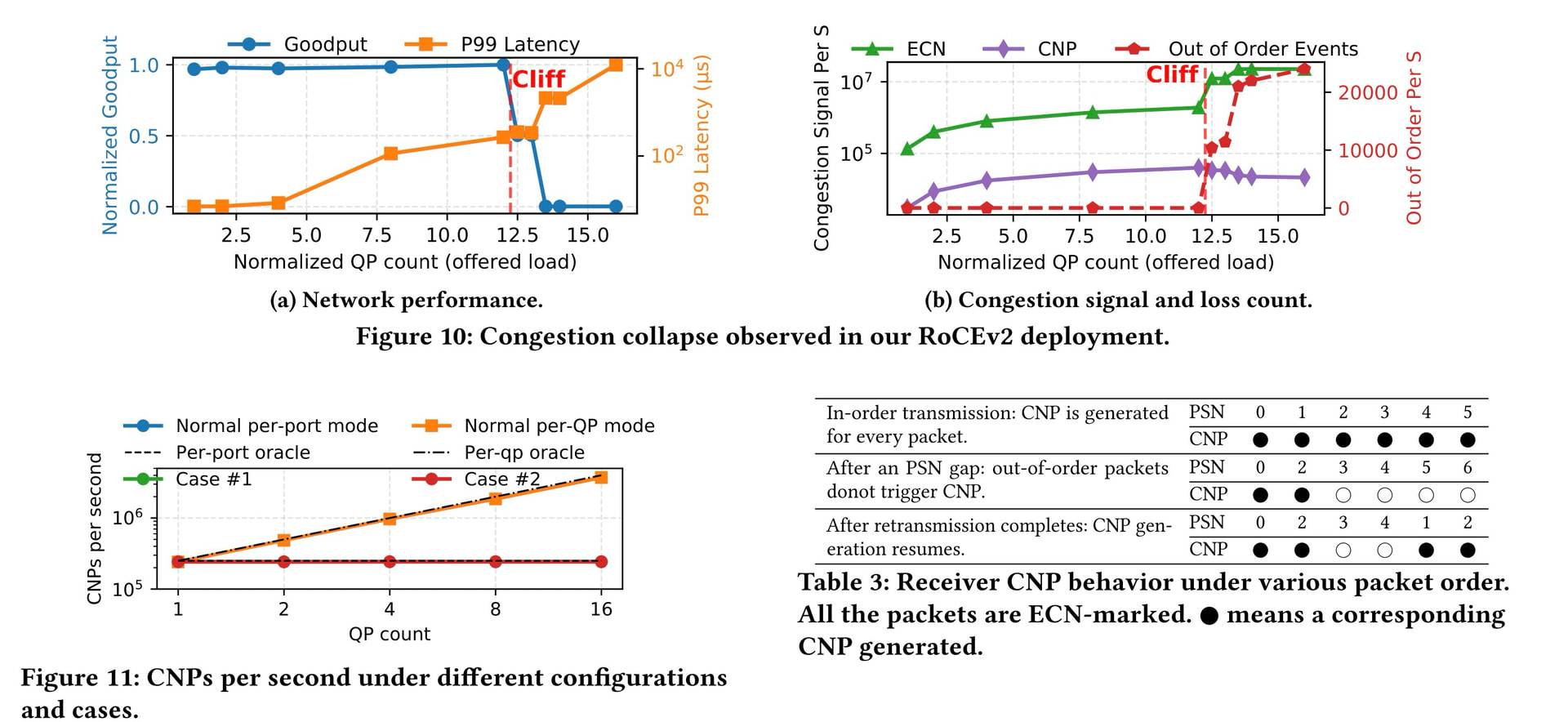

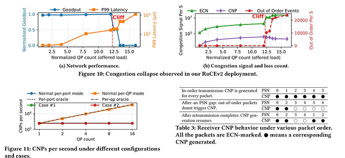

Representative root causes. Anytest localizes congestion collapse caused by receiver-side CNP behavior, incast unfairness caused by unexpected source-QP aggregation under a PER_QP timer, and interval-sensitive DCQCN behavior. It also identifies firmware-dependent congestion-control divergence, sharp latency inflation under ETS scheduling, and unfair bandwidth allocation in a VOQ-based switch. In the VOQ case, identical offered rates still produced a 25/25/50 Gbps split, ruling out ECN and CNP effects and attributing the anomaly to switch scheduling; the issue was fixed by a switch configuration update. In the ETS case, background traffic produced approximately 30 microseconds mean latency inflation and approximately 70 microseconds p99/p99.9 inflation at the worst measured point.
