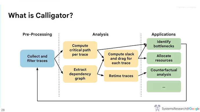

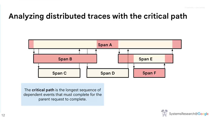

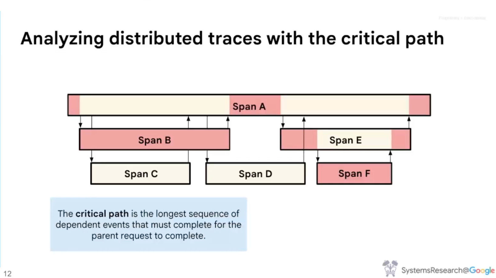

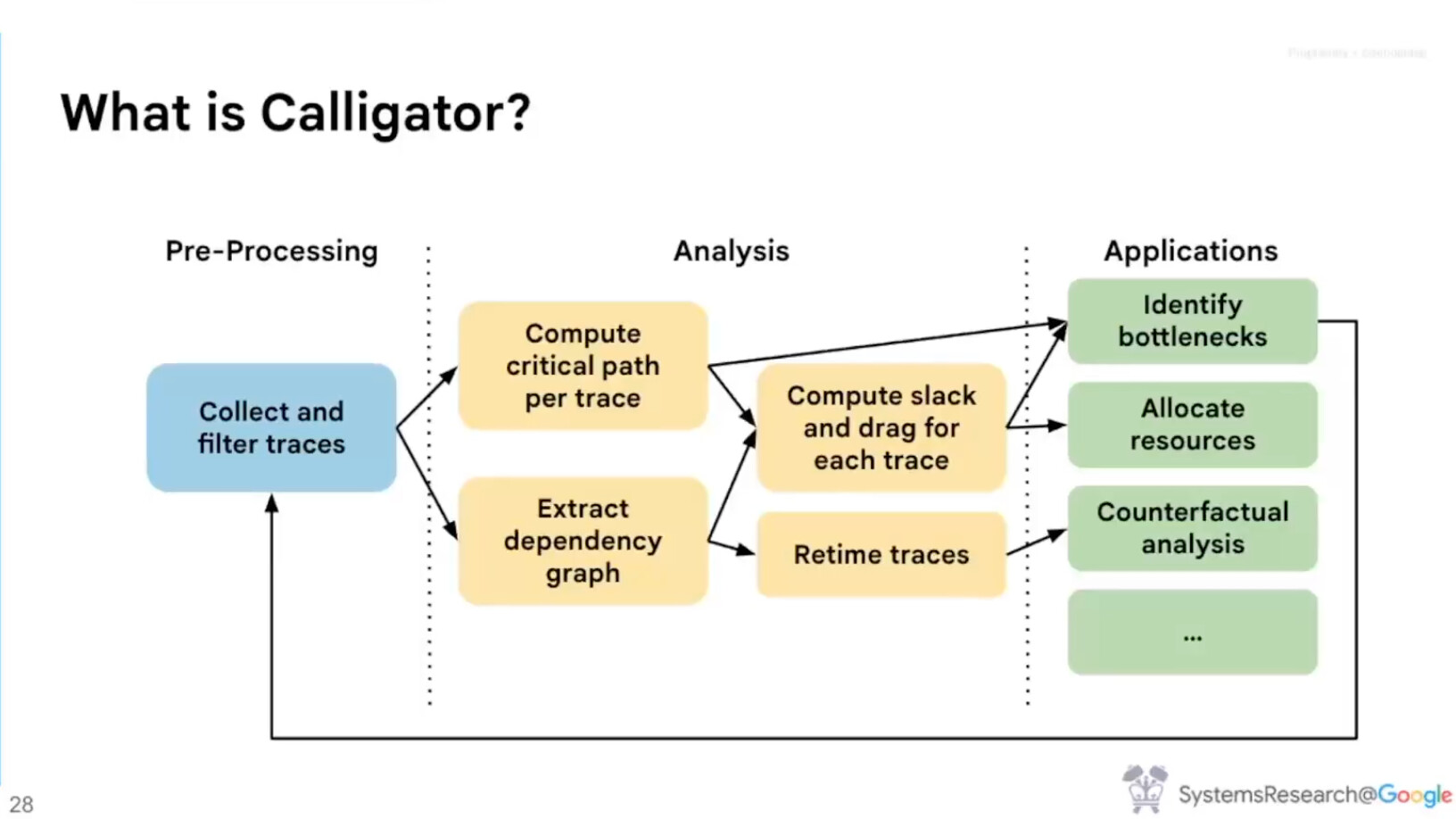

CALLIGATOR compares span interleavings across multiple traces to infer happens-before and asynchronous relationships, then constructs an explicit execution-dependency graph. It models each trace as a structural causal model over span timing variables and traverses the graph backward from request completion to identify the critical path. Unlike methods that rank spans only by duration or parent-child structure, CALLIGATOR distinguishes sequential, parallel, and asynchronous execution, so a long-running span is not automatically treated as a useful optimization target.

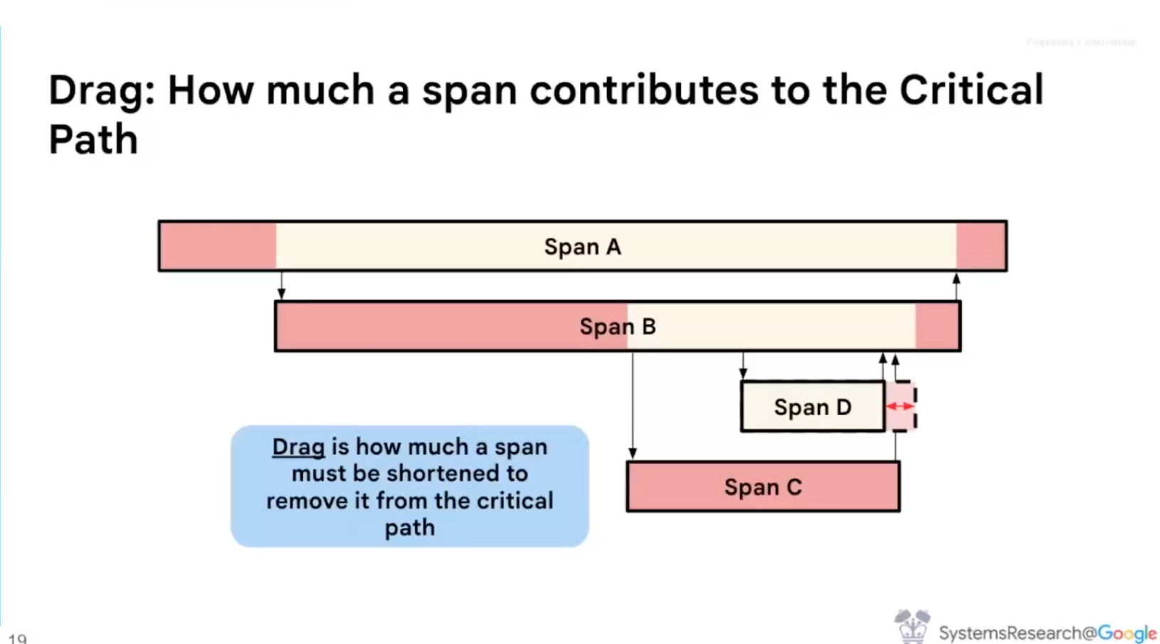

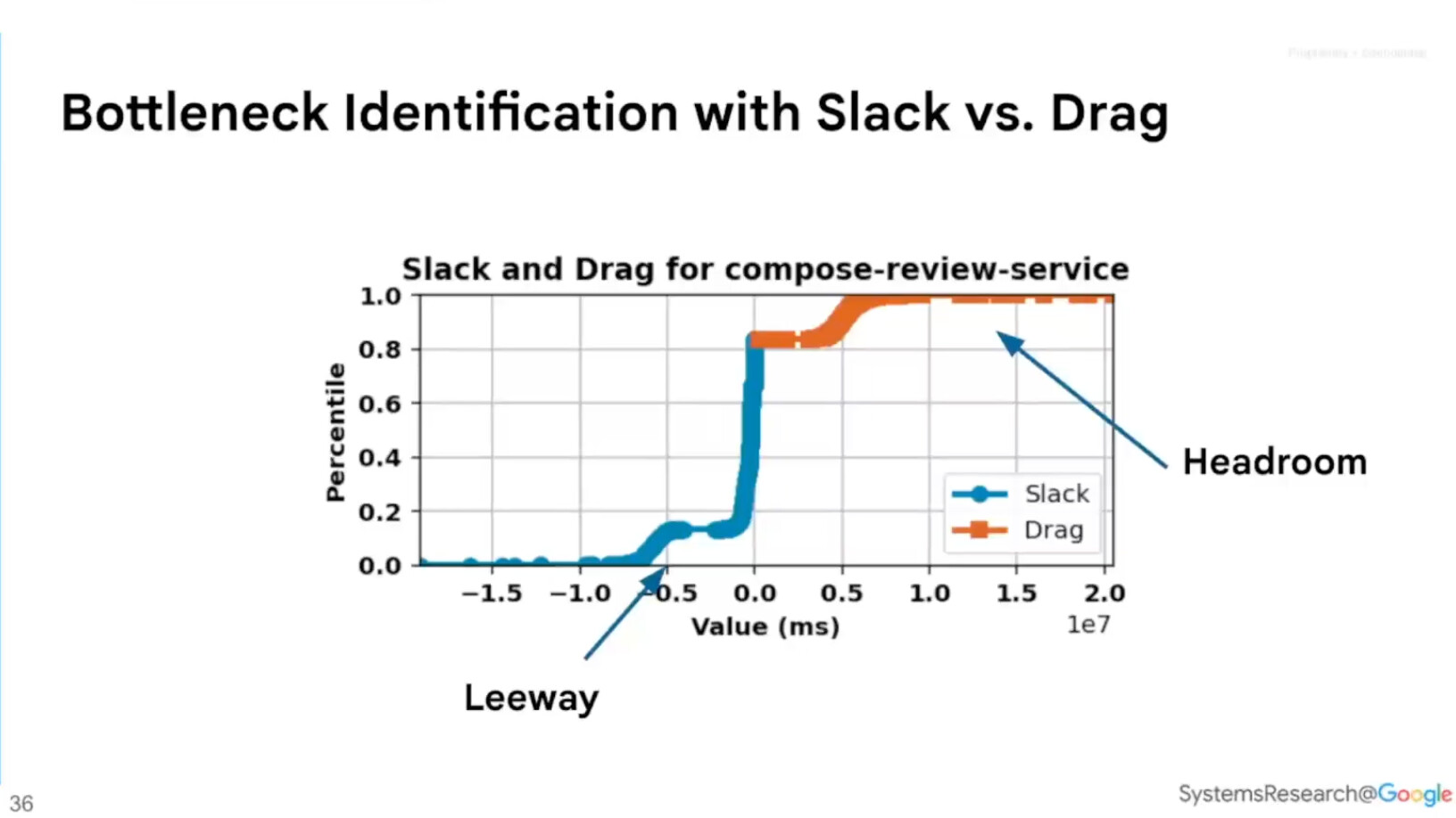

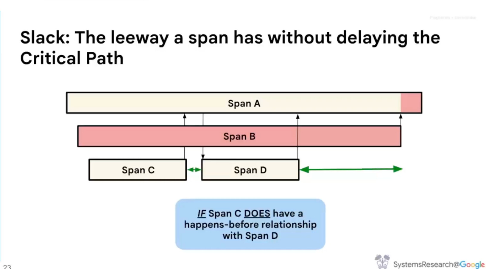

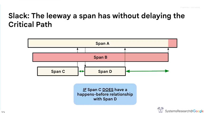

The system derives three interpretable metrics. Drag measures a span’s contribution to critical-path length. Exclusive Drag removes time spent waiting for child operations and isolates the span’s own marginal impact on end-to-end latency. Slack measures how much an off-critical-path span can be delayed without increasing request completion time.
CALLIGATOR then performs retiming: it changes a target span’s duration and propagates the resulting timing changes through the dependency constraints to predict the end-to-end effect. This deterministic process requires no learned model and makes each prediction traceable. The system aggregates these metrics for p99-oriented analysis and applies them to optimization prioritization, resource reallocation, request hedging, and production bottleneck diagnosis.
The authors first compare CALLIGATOR’s inferred dependency graphs with execution relationships obtained through manual code inspection. They then speed up the compose-review service by 6 ms and test whether each method can predict the resulting end-to-end latency change. CALLIGATOR tracks the measured outcome more closely because it captures repeated appearances of the same service and their sequential or parallel dependencies; overall, it improves latency-prediction accuracy by 81.7% over the state of the art. The system also tunes hedging policies, identifies true bottlenecks in production Google applications, and reallocates resources using Exclusive Drag together with utilization. On DeathStarBench, it reduces p99 latency by up to 94.7% with the same total resources. This result is significant because it shows that dependency-aware decisions can direct a fixed resource budget toward components that actually affect end-to-end tail latency, rather than toward services that merely look slow or highly utilized.
