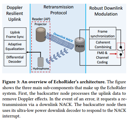

The authors present EchoRider, the first underwater backscatter system capable of reliable operation under mobility. EchoRider introduces three key innovations: (1) A sub-Nyquist chirp decoder that brings LoRa-style frequency diversity robustness to underwater backscatter while remaining ultra-low-power. Unlike traditional chirp decoding requiring high-speed ADCs or complex mixing, EchoRider performs direct sub-Nyquist bandpass sampling, leveraging the fact that underwater acoustic carrier frequency and bandwidth are within the same order of magnitude. (2) A NACK-based full-duplex retransmission protocol that avoids the overhead of ACK-based schemes in high-latency underwater environments. The protocol enables efficient packet recovery by having nodes opportunistically transmit until receiving downlink NACKs, minimizing training sequence overhead. (3) A Doppler-resilient uplink decoding pipeline incorporating adaptive equalization, differential decoding for phase cancellation, polar coding for error correction, and dynamic equalizer retraining to combat mobility-induced channel variations.

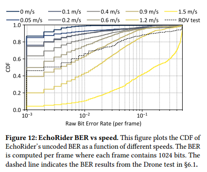

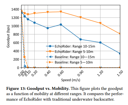

The authors built a complete EchoRider prototype and conducted over 1,200 real-world mobile experiments in river environments using controlled speed platforms and commercial underwater drones. EchoRider dramatically outperforms state-of-the-art baselines, improving bit error rate by over 125× and maintaining underwater goodput of 0.8 kbps at speeds up to 2.91 knots (1.5 m/s), while baselines fail at speeds as low as 0.17 knots. The system achieves a median BER of 4×10⁻³ at 2.5 kbps throughput when nodes move at 0.9 m/s, compared to a baseline BER of 0.25 at much lower speeds. Multi-node deployments demonstrate successful collision avoidance using Aloha-based MAC protocols. This result is significant because it enables practical underwater IoT deployments where mobile platforms can efficiently collect data from battery-constrained sensor networks, opening new possibilities for long-term ocean monitoring and underwater infrastructure maintenance.
Q1: I had a question on your GoodPut results. It seems like the performance improves at moderate mobility rates compared to low mobility rates, and I’m wondering if there’s any intuition behind that.
A1: Part of the reason is that experiments in the river are harder - the river is a more complex environment than the ocean because the multipath is just so significant. Sometimes being further improves the performance than being very close. The difference is really in the noise. At 0.6 m/s, it’s slightly lower but still good performance, and sometimes being at different distances can affect performance due to the complex multipath environment in river conditions.
