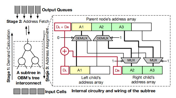

The implementation works at the granularity of fixed-size buffer cells instead of variable-size packets. OBM stores cell addresses with partial contiguity, which lets the hardware fetch several addresses from the selected queue in parallel while keeping fragmentation bounded. A pipelined tree-based interconnect then assigns those addresses to arriving packets without using a large full crossbar. These choices make the push-out path fast enough for line-rate operation and keep hardware cost modest as the port count grows.

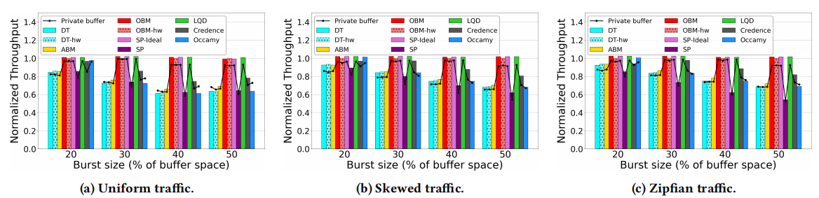

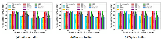

The authors implement OBM in Verilog on an AMD Alveo U200 FPGA as an 8-port, 25 Gbps-per-port switch with a 5 MB shared buffer, and they also synthesize the design with a 15 nm ASIC flow. Under uniform, skewed, and Zipfian burst workloads, the FPGA closely matches the software model. OBM achieves up to 64% higher switch throughput than DT, 52% higher than ABM, 35% higher than Credence, 30% higher than Occamy, and 45% higher than Selective Pushout. With one priority class, its behavior stays close to ideal LQD. The paper measures fragmentation overhead as the share of input packets that are dropped or trigger a push-out even though aggregate buffer capacity is still available; this occurs for roughly 0.3%, 0.05%, and 0.1% of packets under uniform, skewed, and Zipfian workloads, respectively.

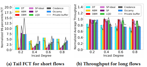

The FPGA design runs at 450 MHz and uses 1.7% of the LUTs, 1.3% of the flip-flops, and 2.4% of the BRAM of the reference switch design. ASIC synthesis estimates about 1.98 mm2 for a 512-port instance at 1.07 GHz. The network-level experiments use a 144-host leaf-spine topology with 100 Gbps access links, DCTCP or Swift, and Incast/Websearch workloads. For a single priority class, OBM gives 2-18 times lower short-flow tail FCT than practical Selective Pushout without reducing long-flow throughput. With three priority classes, it also outperforms classic LQD, reaching 2-12 times lower short-flow tail FCT in the reported settings.
