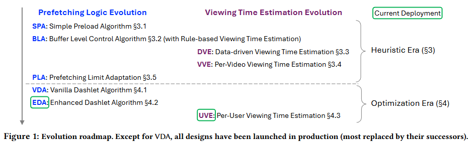

The algorithm evolution proceeds through heuristic and optimization stages, improving prefetching logic and viewing-time estimation together (Figure 1). The heuristic stage starts with SPA, which loads a fixed amount for the current video and then prefetches the next videos. BLA switches between downloading the current video and prefetching future videos according to whether the current buffer reaches a safe threshold. DVE estimates viewing distributions from platform-wide data, while VVE builds separate models for popular videos that account for most views. PLA further adjusts the prefetching range according to the user’s scrolling speed, reducing unnecessary downloads for more distant videos.
In the optimization stage, VDA places segments from the current and future videos into a unified decision process and chooses the next segment according to stall and bandwidth costs. EDA then prioritizes the first-frame segment because users are especially sensitive to startup waiting. UVE moves personalized estimation to the device, using a lightweight multi-task model to predict viewing time for the current video and the next seven videos, and reusing the result during one viewing session. The prefetching decision and viewing-time estimation work together to allocate downloads according to expected viewing demand while coordinating startup delay, playback smoothness, bandwidth consumption, and on-device overhead.

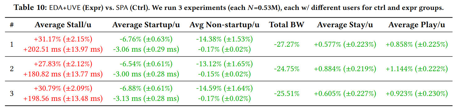

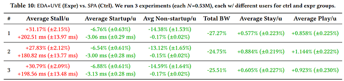

In three end-to-end experiments, EDA+UVE improves stay time over SPA by 0.577%, 0.884%, and 0.605%, reduces bandwidth by 27.27%, 24.75%, and 25.51%, and cuts startup delay by approximately 181–203 ms. These results capture the cumulative effect of multiple incremental improvements across the complete production pipeline (Table 10).

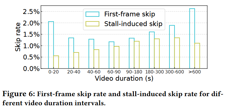

VDA places the current and future videos into a unified stochastic decision framework, reducing stalls by 2.92% and bandwidth by 3.39%, while adding 18.90 ms of startup delay. After EDA adds a first-frame startup penalty, stay time and play time increase by about 0.05% and 0.06% over VDA. First-frame skip rates are higher than stall-induced skip rates across video lengths, especially for short videos, indicating that users are more sensitive to startup waiting (Figure 6).

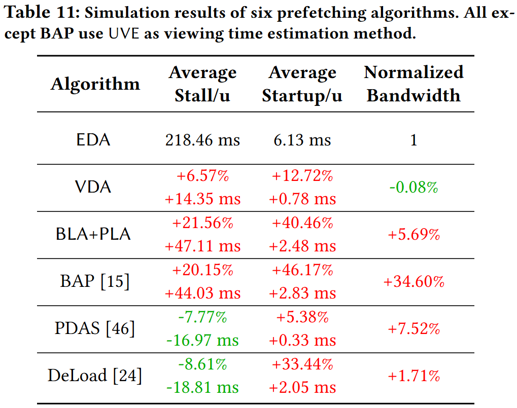

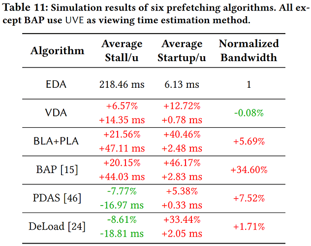

In simulation over 435 network traces and about seven million playback events, EDA’s average startup delay is 6.13 ms. Using EDA’s bandwidth as the baseline, VDA is nearly unchanged at -0.08%, while BLA+PLA, BAP, PDAS, and DeLoad use 5.69%, 34.60%, 7.52%, and 1.71% more bandwidth, respectively. EDA achieves a strong balance among startup delay, playback smoothness, and bandwidth, consistent with the online findings (Table 11). These results matter because they show how a sequence of production-tested decisions can improve engagement and reduce network cost simultaneously.
