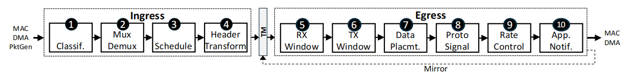

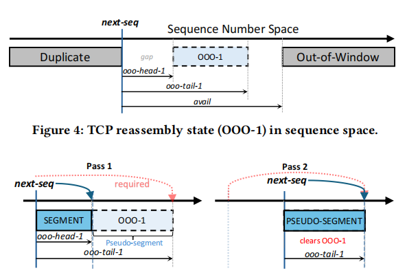

The difficulty is that TCP and RMT were built around very different execution models. TCP reassembly, retransmission, flow control, congestion control, and bidirectional coordination all create dependent state updates. An RMT pipeline is unidirectional, stage-local, and lock-step. A direct implementation therefore runs into forward-read dependencies, circular writes, recirculation, or serialization, any of which can remove the throughput advantage of the pipeline.
Presto expresses TCP processing as a sequence of small match-action operations and introduces three mechanisms to handle the dependencies. Optimistic concurrency lets an early stage act on a speculative value and validates the update later. Pseudo-segment injection turns circular state dependencies into lightweight control events that pass through the same pipeline instead of stalling the original packet. Bump-in-the-wire processing keeps the common data path to a single pass and places data directly for the application.
With these mechanisms, Presto offloads core TCP transport logic for established connections, including retransmission, bounded out-of-order reassembly, flow control, congestion control, and application notification, while retaining TCP/POSIX compatibility. Connection lifecycle management and uncommon processing remain in a CPU control plane. The main Tofino 2 prototype validates the hardware data path, while the OOO-1 SACK variant is evaluated only in simulation because of compiler limitations; the authors also port the stateful egress pipeline to an FPGA SmartNIC. The broader contribution is therefore a way to map dependency-heavy stateful transport processing onto a match-action pipeline, not just a faster TCP datapath for one device.

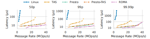

The main testbed has eight 32-core Intel Xeon Gold 6430 machines with 200G Mellanox ConnectX-6 NICs configured in 100G mode, connected to a 32 x 400G Intel Tofino 2 switch. In the RPC benchmark, Presto sustains nearly 40 million operations per second, 1.67 times TAS, with about 18 microseconds median latency and 24 microseconds at the 99.99th percentile. It sustains 32K connections without a throughput drop. At pipeline scale, the system approaches 1 billion packets per second while keeping RPC tail latency around 20 microseconds. For single-core streaming, Presto reaches about 25 Mpps independent of segment size, matching RDMA. At an 8 KB MTU, that packet rate corresponds to more than 1.6 Tbps of processing capacity; it is a rate-times-packet-size extrapolation rather than a measured end-to-end 1.6 Tbps transfer. TAS is limited to roughly 5 Mpps per core.
